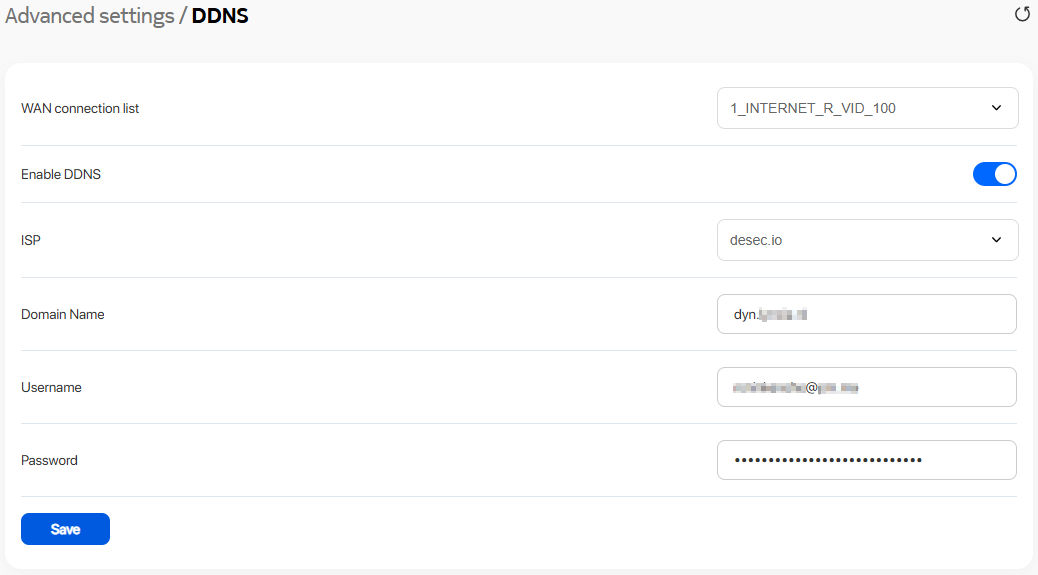

Hello, I’ve configured my Nokia fiber router/firewall as follows.
But it doesn’t seem to update the A-record that corresponds with this domain.
I’ve set up the A-record with a temporary address.
What could be the issue? AFAIK I’ve configured the DNS and DDNS correctly.
The token keeps saying it has never been used. And it’s value should be correct as well.
I’ve also allready made sure my provider isn’t using CGNAT.
Thanks for any input you might have.

Hard to tell which one you actually used. The “Password” in that router form isn’t your account password. You should use the token that you created.
Hmm, yeah that’s what I understood regardless of which username I used before. It is the token in the password field…
What would your advice be moving forward, create a new token and try that one? Do you think my configuration of the domain is correct?

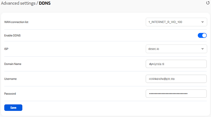

So in my router I have configured dyn.test.com as domain and user.
In my DNS I have an A-record defined as A dyn 100.100.100.100

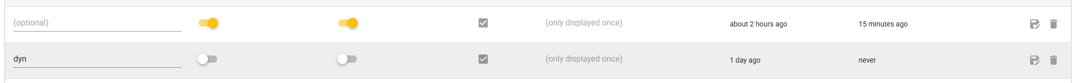

My original token was issued related to dyn as you can see in the second screenshot. Or do I need to leave the field ‘name’ empty?
I will create a new token and test that.
The name is just so that you can tell the tokens apart in the user interface. It has no relevance to the token’s function. Tokens can be restricted to certain domains, even down to individual subnames and record types, but that isn’t exposed in the web interface. You’d need to use the API to create policy restrictions. All tokens you create in the web interface can from the get-go modify all domains and records in your account.
So, I created a new token, added it to my router.
And again I see that an additional token line is added to the tokenlist.
Probably an update by my router.
But the new token I added myself doesn’t get the mention “last used”.
The token added by my router now has a mention “less than a minute ago”.
I also removed the existing A-record as the token should be able to create and delete domains.

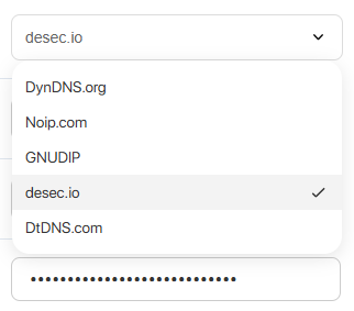

It appears your router does some unnecessary elaborate dance there. Does it have a “custom” option where you can just enter an update URL? That may be easier to use.
Afraid not, it only has a preconfigured dropdownlist of DDNS-providers.

That is your log-in token which is used by the web interface. (Technically it just uses the API.)
That’s only the case if you turned on those permissions in the token configuration in the web interface. But, to create a record, it’s not necessary to have permission to create a domain.
If the domain already exists, a token with default settings will be able to create an A record inside it.
