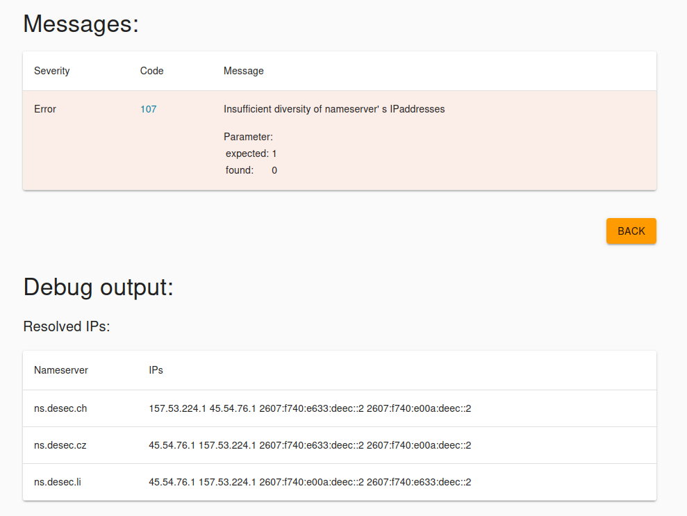

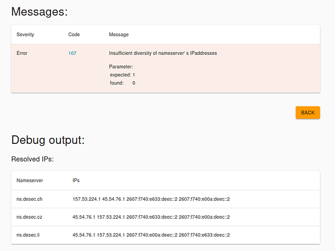

Hi peter, as discussed here, DENIC does not accept the ns. solution due to their requirement of having nameservers on different physical networks. While this is the case for your new solution, it seems they are unable. to detect that correctly. Therefore I’d be glad if there was a solution using the classical ns1 and ns2 names.
That’s what DENIC has to say about the European TLD Nameservers in their predelegation checker:
We’re in touch with DENIC and hope they’ll change their policy some time next year.
