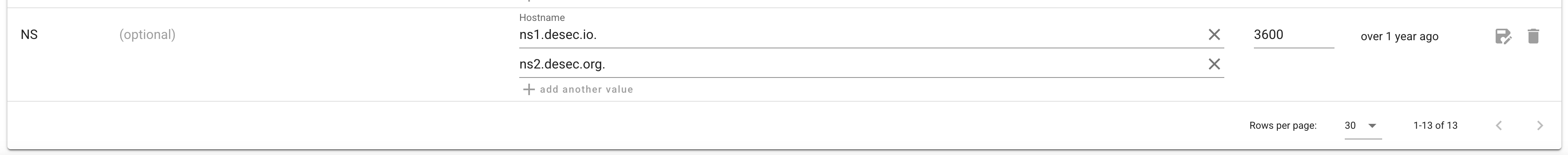

I’ve changed the NS on my registrar, do I need to update them in the deSEC zone too? The zone has the standard NS
Stupid question, mainly because my brain is having a Friday brain fart…
Hi Faisal,
By the RFC letter, it would be better to, but it is not required. Some registries however insist (e.g., .it).
From a resolution perspective, it makes no difference, as the resolver first sees the parent-side NS records and resolves them into a set of IP addresses. Some resolvers would later attempt to also resolve the child-side NS, but they lead to the same set of IP addresses.
