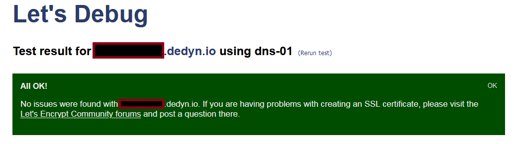

You might try Let’s Debug to assist.

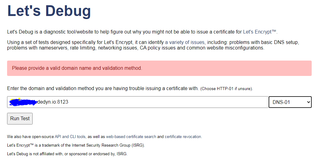

It doesn’t allow to give a domain with a port : domain.com:8123
The Challenge Types - Let's Encrypt the HTTP-01 challenge states “ The HTTP-01 challenge can only be done on port 80.”
So why should it accept a port of 8123?
This will probably not work for IPv6. Port forwarding is usually only configured for inbound connections to the router IP(v4) address.
Doesn’t need to. “certbot-dns-desec” is used for the DNS-01 challenge. I don’t think getting the certificate is a problem. The browser connects to an address and port where NPM isn’t listening for a HTTPS connection. Probably this: The high port isn’t exposed/published by the NPM container and the router doesn’t NAT the connection to the default port that is exposed.
Then the OP was using Let’s Debug incorrectly, they should have used the DNS-01 drop down selection instead of the default HTTP-01 selection.
Do not add a port for the DNS-01 challenge, it is using DNS not HTTP.
