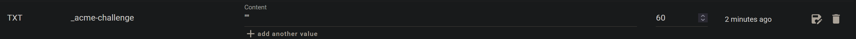

after I did MANUALLY save the EMPTY (““) txt _acme-challenge record in desec.io

again, it just works, if I “dummy save” the empty TXT record
