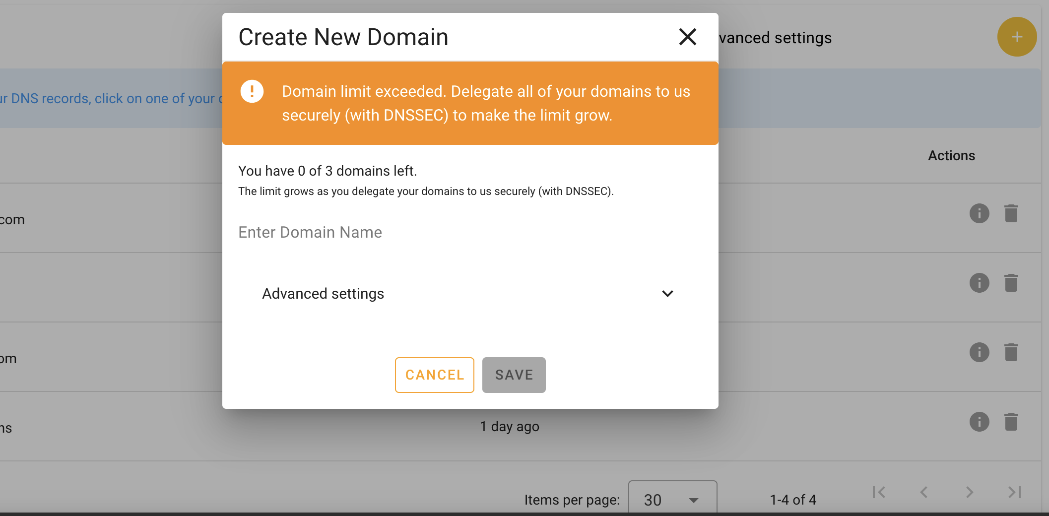

To be fair, IMHO the current tester is broken. I havn’t really bothered, since I currently don’t want to add a domain. But I have 4 domains, all with working DNSSEC and I still get this:
maybe it has something to do with the old manual limit. AFAIK I asked support to have more than 3 domains and got 15 or something.
How great that you know exactly what’s up :slight_smile:
As I stated before i got one domain, which is such a special zone that I need to check if they even support DNSSEC, which leaves me in a situation that I got 5 domain, 4 are secured and 1 isn’t. And I’m just saying that it would’ve been great to be informed before these changes apply.

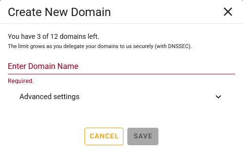

However, i found out that if your limits are stuck, you can trigger a re-check if you try to add a new domain to your account. The API will return a answer saying that you reached your limits, but at the same time it will trigger a re-check to check if your domains are DNSSEC protected.
If you are on the “new limits” it should look like this and it should automatically increase, but like i said you can try to trigger a re-check if u try to add a domain via the API.

Also funny that I have 4 domains running but the webGUI tells me that I have 0 left out of 4 :grinning_face_with_smiling_eyes:
Hmmmm, very weird. I sadly can’t try it right now because i do not have any more domains to add at this point. But it worked for me last week and i also had to read about the “new limits”. I migrated one domain after another, then hit the limit, re-checked a few times and then i was able to grow the limit and add the remaining domains.
