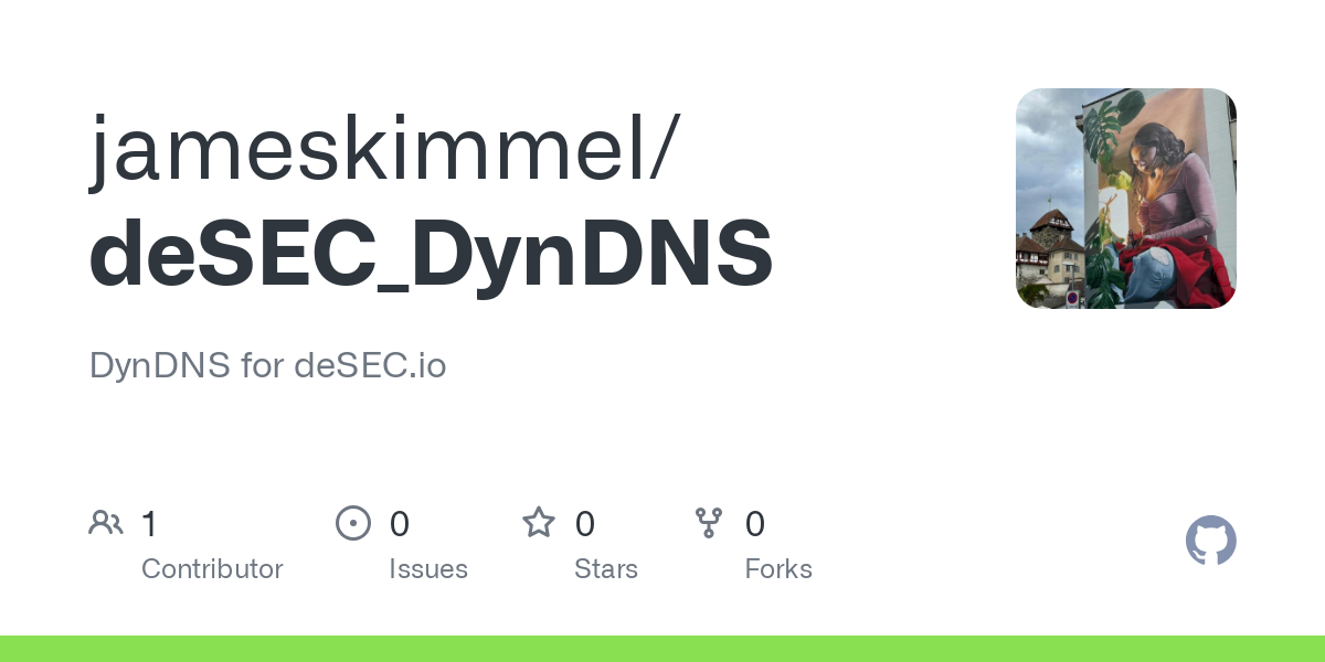

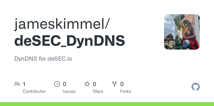

If you need a simple shell script for the second option, here is a shameless plug of my script that is looking for testers besides fiwswe :grin:

Another option would be to use my script, which basically does the same as the curl above, with the difference that it checks for changes and only then issues the update curl.

I just read through your script. However, it is unclear to me whether I am supposed to set these to YES or not.
PRESERVE_IPV4='NO'
PRESERVE_IPV6='NO'
I am thinking if I set them both to YES, they will not update the IP address at all. At least that is how I read it… But they should update both. It is just that IPv6 should only set the AAAA record and IPv4 should set the A record. But both records should end up being there. AND they should both be updated regularly as the dynamic IP might change…
Since you want to update them both, leave them both at no.
That is correct.
Ahh I see where you are coming from.
The default behavior is to leave them both at no. That way it updates both.
You only need to set it to yes in certain situations.
For example, you have bought a static IPv4 and only want to check IPv6, set it to preserve for IPv4. Or more realistic, you manually set a IPv6 IP in the webGUI to point to your static IPv6 host, but you are using the script on a different host or a host without IPv6, by setting it to preserve, it won’t touch and won’t override what you did in the webGUI.
Hope this makes it a little bit more clear. Maybe I should think of a better naming than “preserve”. I used that, because that is what deSEC calls it.
Maybe “disable_IPv4_check” or something like that would make it more clear. What do you think?
