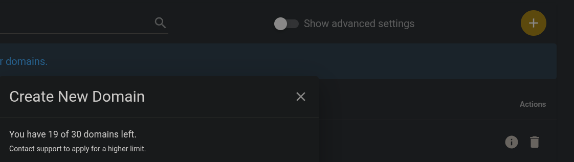

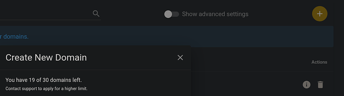

They do make the limits pretty clear when you click on the + sign. Maybe the UI is different for new accounts? It would surprise me though. I registered in a time where the limit was 10 by default, and asked support to be granted a limit of 30. They reacted super quick and increased it for me, and as a little thank you, I left a donation equal to my new limit.
