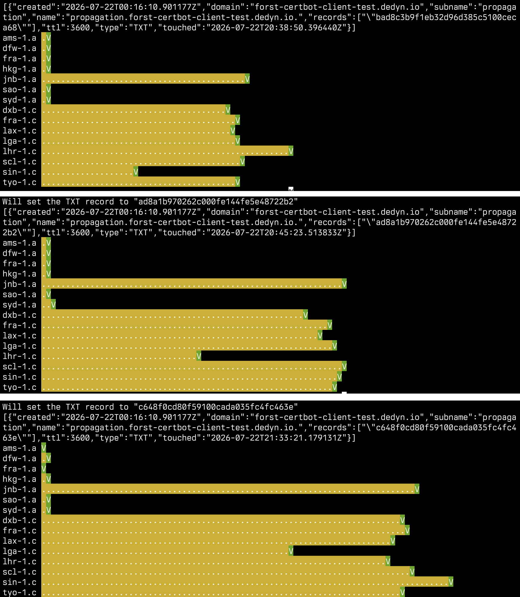

This was useful, thank you! The tool you linked inspired me to write a slightly different one: GitHub - Forst/desec-heatmap: Unofficial tool to test deSEC change propagation · GitHub
It creates a random TXT record on a given domain/subname through the deSEC API, and then periodically (2 seconds by default) pokes the known geographic servers until they all return the same new random TXT value. The output looks like this:
Each vertical column is 2 seconds. Green means “good”/done, “yellow” means it hasn’t synced yet (no record, or multiple records in the RRset), “red” means error (timeout, refusal etc).
Made a few runs, and here are some observations:
  • Most *.a.desec.io servers sync very quickly, typically within 4-6 seconds.
  • jnb-1.a.desec.io consistently and significantly lags behind. In the bottom run it took 156 seconds.
  • All of *.b.desec.io aren’t responding to external queries, and hence were excluded.
  • *.c.desec.io are also quite slow to sync changes, though the purpose of these is not known to me. These weren’t listed in the desec-io/desec-debug list of frontend servers, I found them through exploration. Thought I’d include those anyway. The worst run I’ve seen so far was 170 seconds for sin-1.c.desec.io.
These values are approximate, but should be enough to get a general idea of how it’s doing.
With these kind of figures, it wouldn’t be surprising that certbot plugiun’s default 80-second propagation window may sometimes not be enough.

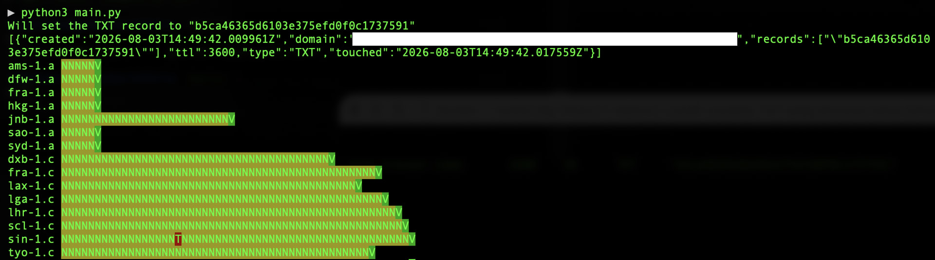

I do see a similar behavior during acme.sh challenge creation and cleanup.
watch dig +tries=1 +time=2 +noall +answer TXT _acme-challenge.qnap.xxxx @ 1.1.1.1
toggles between existence and non-existence. This causes the letsencrypt verification to fail.
I have also observed that ns2.desec.org does not get the _acme-challenge.
watch dig +tries=1 +time=2 +noall +answer TXT _acme-challenge.qna.xxxx @ ns1.desec.io
watch dig +tries=1 +time=2 +noall +answer TXT _acme-c@ns2.desec.orgallenge.qnap.xxxx @ ns2.desec.org
I will look into GitHub - Forst/desec-heatmap: Unofficial tool to test deSEC change propagation · GitHub
and now one holds the value of the first run and @ 1.1.1.1 toggles.
Apparently it counts down the TTL…
