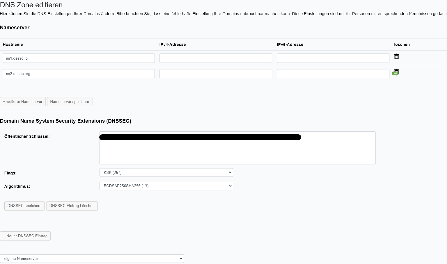

I would like to link my Netcup Domain to deSEC and from deSEC to my FritzBox.
  1. So I put in the two deSEC Nameservers and set up DNSSEC as well. Is it setup correctly? The flags and the algrorithm and IPv4 / IPv6 blank?
  1. Now I would like to link deSEC (dynDNS) to my Fritzbox, so that I can use wildcard subdomains. How can I achieve that?

Check with a tool such as DNSViz to see if DNSSEC is correctly set up.
BTW: The public key is published in the DNS system. No need to hide it as it would be very hard to get any useful information from that, without first knowing the domain name.
Hopefully that is a typo? The NS should be: ns1.desec,io., ns2.desec.org.

I know that this is a public and not a private key but safe is safe;)
This is a typo problem everytime I would like to add an . at the end. Netcup does not save the changes.

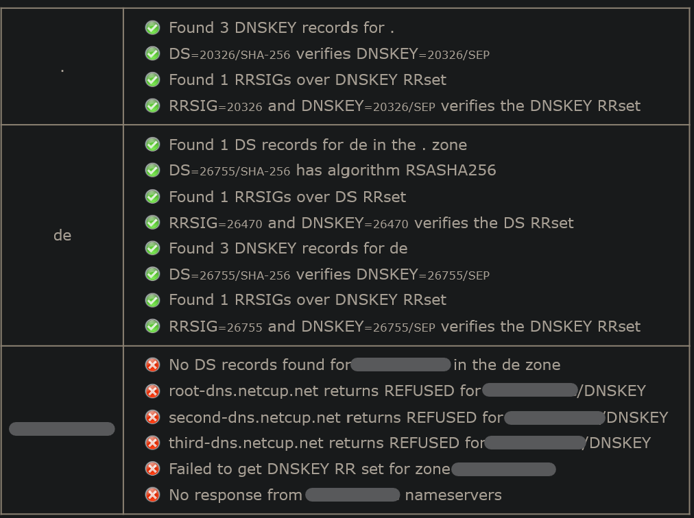

Okay I have started from scratch. The first Screenshot from above shows my config. I have not changed there anything at all. I have deleted all entries in the desec interface. That is my result with the dnssec test:
When I check the Nameservers with MXToolBox DNS Lookup: It says “Sorry, we couldn’t find any name servers for mydomain.de”. What am I doing wrong?
Without knowing the actual domain name we can only speculate. The lines in the screenshot referencing netcup nameservers indicate that the domain is not even delegated to deSEC yet.
Now netcup might or might not offer DNSSEC themselves. I have no info about that. But if you want to use their nameservers and their DNSSEC then you are discussing this in the wrong forum. The same goes for some sort of dynDNS support. Since we are discussing this here, the assumption is that you want to use deSEC.
Things to check:
  • Verify which are the authoritative nameservers for the domain? (dig domainname ns or dig domainname soa should give the answer.) If you want to use deSEC then these should be ns1.desec.io, ns2.desec.org. Note that setting the NS records in the zone at your current provider (netcup) is not enough. The domain must be delegated to deSEC, i.e. the NS delegation records must be set in the parent zone (.de). Most domain registrars allow delegation to different nameservers in their web UIs.
  • To get DNSSEC to work (once the authoritative nameservers support that) the DS records must be set, again in the parent zone (.de). Again the domain registrar will need to communicate with the .de registry to do this, as the domain owner (you) doesn’t have a direct contractual relationship with the registry.
Hint: In my experience with multiple domain registrars the .de registry wants the DNSKEY values not the DS values for setting the DS records. Consequently the domain registrar will also want this value to handle setting the DS records in the parent zone.

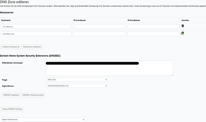

I would like to use desec. I have written to the Netcup support team and they mentioned the .de registrar proof domain: https://nast.denic.de/ I put in the desec domains and have no issues. So I think I have to wait until netcup has configured it.
Disclaimer: I have never used netcup.
Going by their FAQ you can set the authoritative nameservers yourself. No support ticket required.
They even seem to have a web UI for setting up DNSSEC with external nameservers:
Yes, I know. That is what I have done in my first screenshot above. But it is not applied directly as shown in your Documentation link.
Since we are going back to check the basics: Did you register your domain through netcup or some other domain registrar?
I have registered it through netcup.
Ok. So if you have problems getting their documented methods to work, contacting their support is the correct way to solve this. Let’s wait until the the domain has been delegated to deSEC.
Just chiming in as a Netcup customer. The Netcup side setup looks about right to me. Mine seems to be identical and my domains got delegated to deSEC without any issues.
I don’t recall how long it took for the changes to propagate, but it wasn’t excessively long.
Okay it was a problem on the side of netcup. The support has fixed it. Now the correct nameservers are set.
