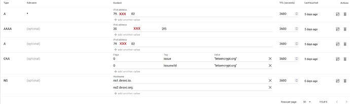

Record Sets SUBDOMAIN.dedyn.io are:
I am trying to create a single wildcard CNAME record “*.SUBDOMAIN.dedyn.io” for all my services. With the latter “any_string.SUBDOMAIN.dedyn.io” should resolve to the IP of “SUBDOMAIN.dedyn.io”.
I didn’t get how to achieve that and after founding no soution, I tried to configure HAProxy, but it still - presumably - resulted in the same error.
  • Could I please get some advice on what I need to configure instead of CAA + CNAME for deSEC, or what I can read up on if CNAME can only be entered alone?

According to the screenshot of your zone you already have a *.SUBDOMAIN.dedyn.io. A RRset. So no CNAME RRset for that name is possible. With the proposed CNAME I’m not sure why you would need that A RRset?
The CAA RRSet should not matter here, as it is for SUBDOMAIN.dedyn.io. not *.SUBDOMAIN.dedyn.io..
Hello and thank you for the information.
I deleted the A record with wildcard and therefore I could add CNAME with wildcard. Thanks!
