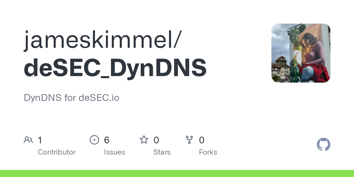

After my GO script, I decided to write something simpler in bash.
deSEC_DynDNS is a very basic bash script that caches the last set IP and only issues an update command, when it changed.
It can’t catch errors and is unable to handle timeouts or anything like that. It also can only handle a single domain.
If you have any feedback or suggestions, I am happy to hear them. I don’t know if I can implement them, since I currently don’t have a lot of time and I am not a coder.
Maybe this is of use for some of you.

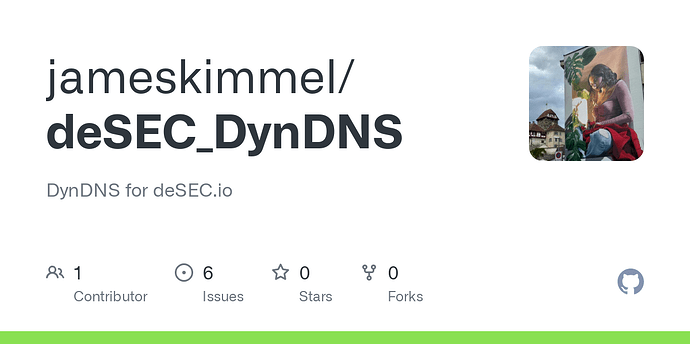

The script is no longer bash but now shell and has little to do with the original.
It should work on OPNsense, macOS and Linux.
Added some fallbacks and timeouts, in case something goes wrong with your connection.
I could not find out on how to get the header code and the “normal response” at the same time. That is why there is no checks for the “get the host IP” curl command.
Should not be that important, since worst case would be that the response IP is empty and there is a needless update url call because of that.
Other than that, it is pretty much done and works (at least for me) fine.
