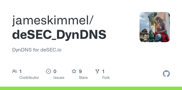

Also if you want to use a more “intelligent” solution than just running these two curls, here is my shell script so you don’t request an update every minute:
