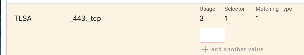

There’s no API to add a record to an RRset. You can patch the RRset with the new record, but you will have to repeat the existing ones in the records array.
What’s shown on your screenshot is just a visual trick; the web interface actually does the same thing.
