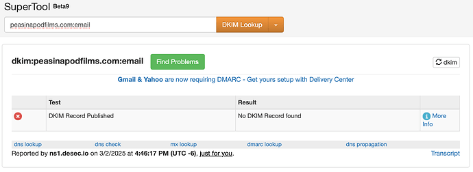

If I do a check on MXtoolbox with peasinapodfilms:email I get a ‘No DKIM record found’ message

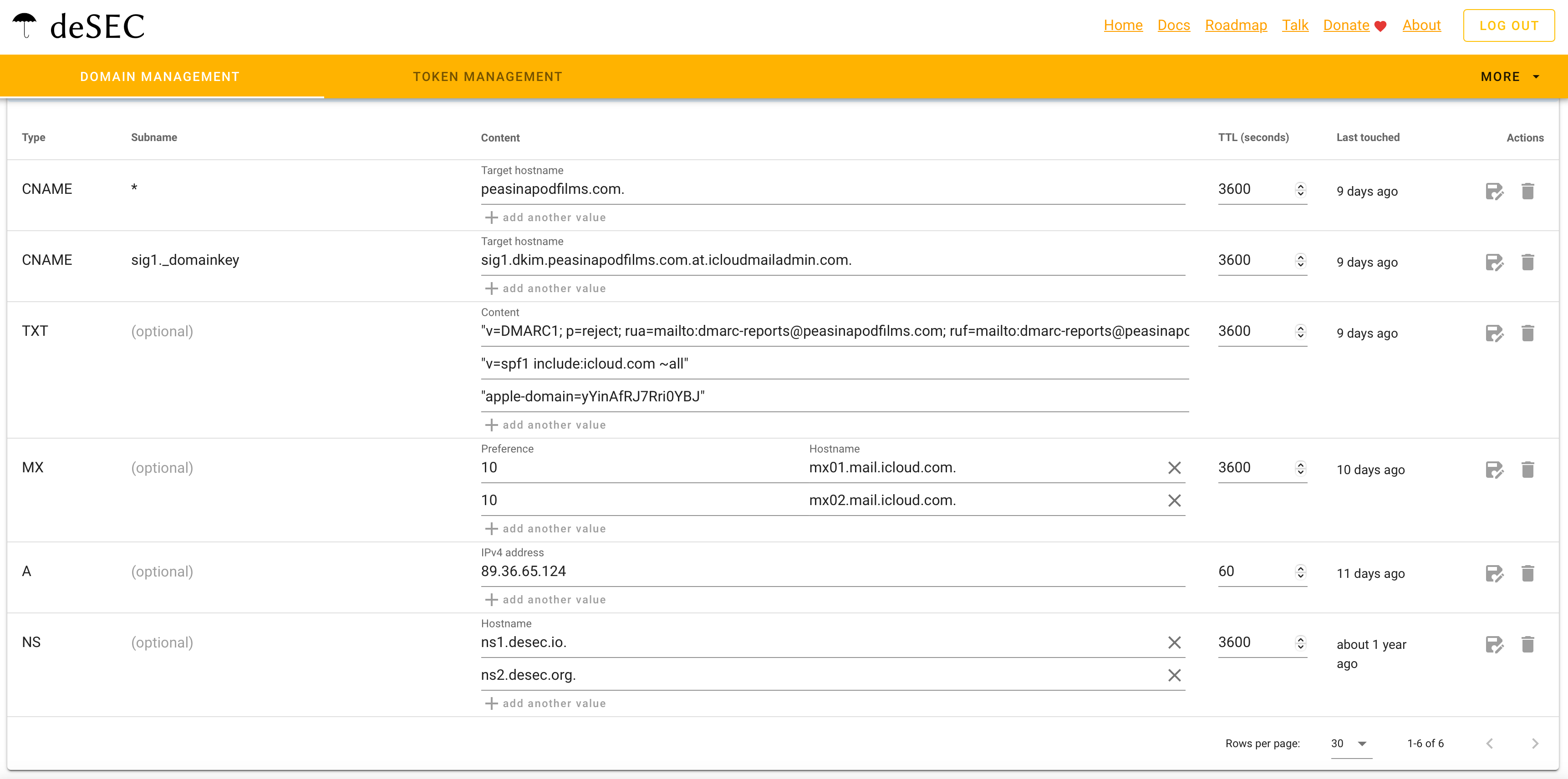

This is how I have things set up in deSEC
The full DMARC entry is:
“v=DMARC1; p=reject; rua=mailto:dmarc-reports@peasinapodfilms.com; ruf=mailto:dmarc-reports@peasinapodfilms.com; pct=100”

There is no DKIM key at email._domainkey…, so MXtoolbox complains about that. You asked the wrong question: The selector is “sig1”, as in the subname “sig1._domainkey”, not “email”.
Thank you! Ok, so the DKIM appears to be fine after all!

Hmm, the DKIM record is a “TXT” record, and lives at (subname) “mail._domainkey”.
DMARC lives in a “TXT” record at subname “_dmarc”
The spf1 record is in the correct spot.
Ok, so I added the DKIM as instructed by Apple. Are you suggesting I have have placed the DMARC incorrectly?
The DMARC record must indeed be at _dmarc.peasinapodfilms.com. But your wildcard-CNAME directs _dmarc to where the record really it, so that does not seem to be your problem.
Moreover, if it wasn’t in the right place (or not there at all), your mail would not get rejected but rather accepted without validation.
IIRC your DMARC policy mandates that your email must validate with SPF or DKIM, i.e. either one is acceptable. If your emails get rejected, that would imply that both SPF and DKIM fail, which is surprising.
