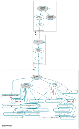

I checked with DNSViz.net and I got these results, what are these errors and how do I fix them? My domain is sevenangelsmassage.com.
Please stop posting more screenshots (I’ve already removed seven). You already have shared the link.
You can fix this by following the instructions. It looks like you did not even do the first few steps.

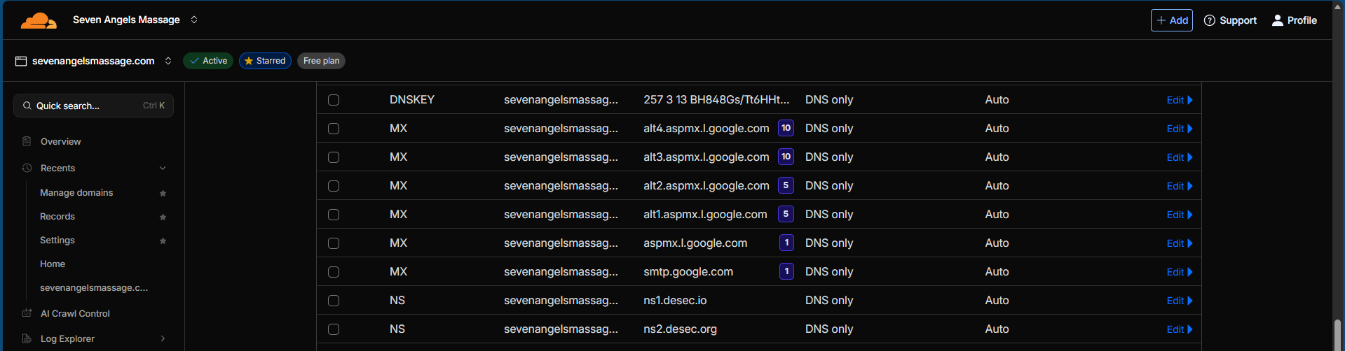

Sorry about that, I already have the DNSKEY records of deSEC into Cloudflare and the NS records. I also did the same from Cloudflare into deSEC, I will show below with another screenshot.
*Edit: Seems like I’m limited to a few posts as new member here, that’s all I can share for today.
