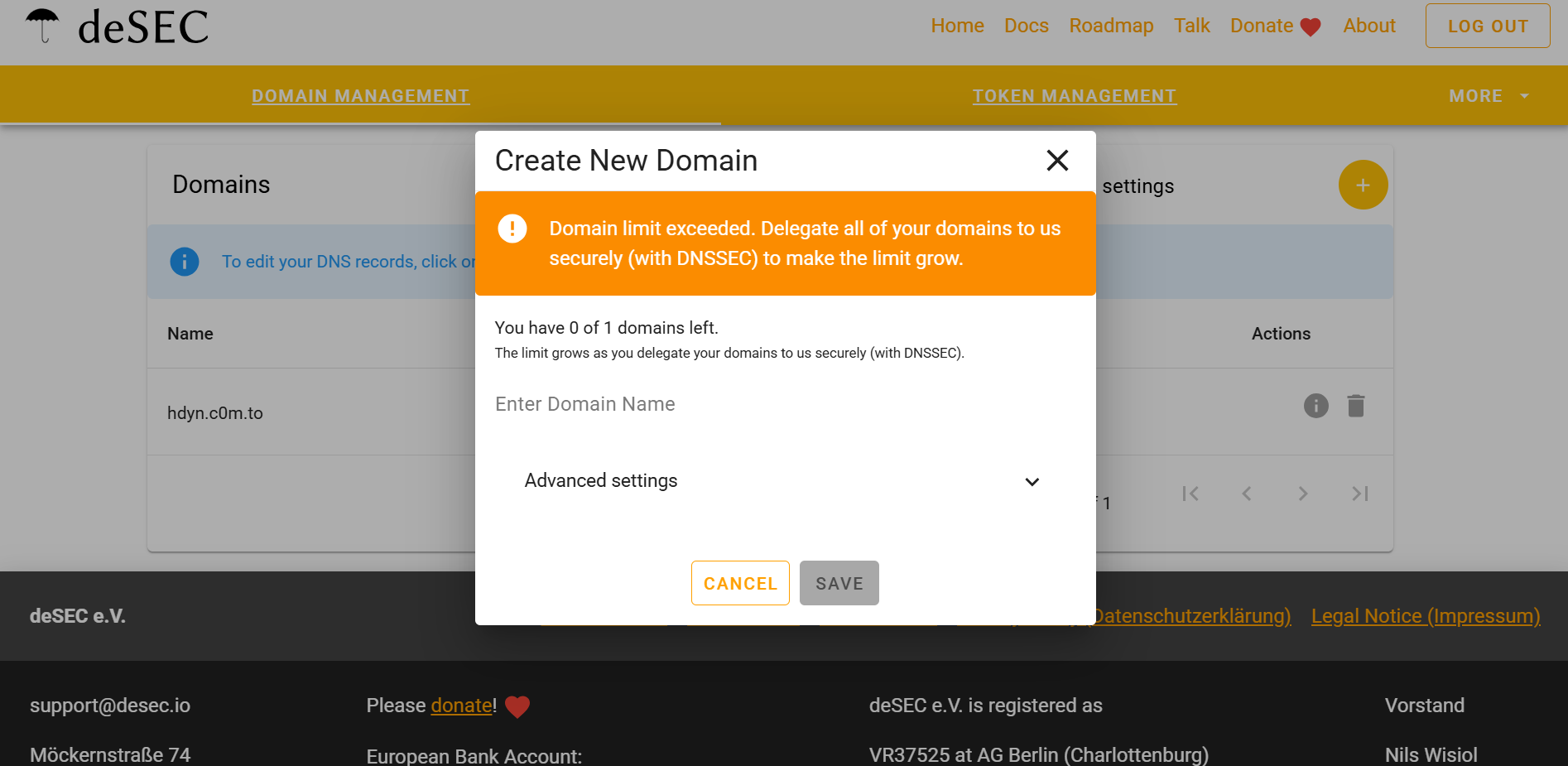

Hi all, I just wonder how long it takes for the automatic domain limit increase. Should it be instantaneous? Or the day(s) after? I’ve created my first domain and secured it with DNSSEC and dig says that it was successful. What have been your experiences?

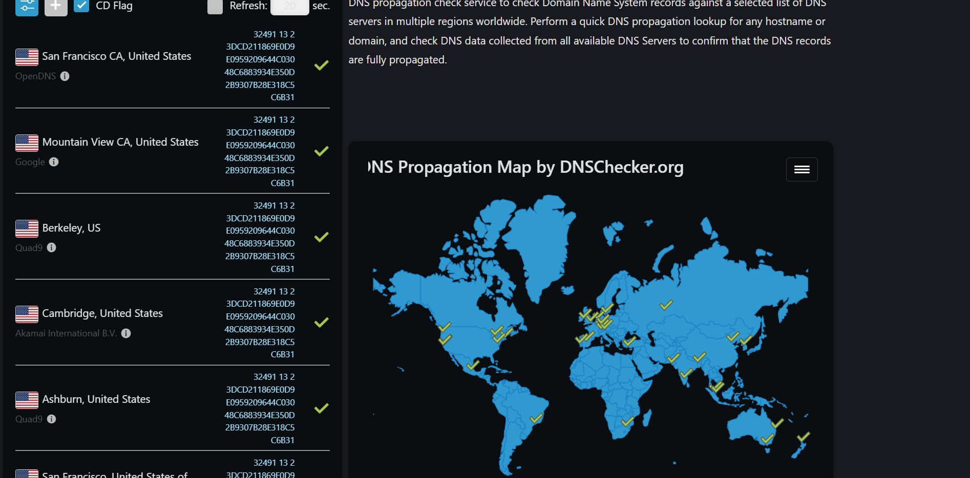

Took me a day on my domain. even while the famous online checkers confirm, the caching DNS deSEC uses needs to timeout its current values…

Hi! For me it did not update. I did a DNS check and stil nothing
check again couple of minutes later. each time you try to add a domain and you get that limitation error, the api is running a verification in of minutes. it might become ratelimited though according to sourcecode
Is it possible that this immediate validation is triggered only when using the API (and not the web interface)?
Hi! I did use the rrset api to add a new rrset to my zone but stil nothing
you can trigger the re–check if u try to add a new domain via the API, yes.
Yes, my point was: You should try to add a new domain via the API. Trying to add it via the Web interface does not trigger the re-check. (But that’s just my guess.)
Hi! I did try this but got this:
{“detail”:“Domain limit exceeded. The limit grows as you delegate your domains to us securely
(with DNSSEC); we are re-checking yours now.”}
After that try again after a few seconds. If all domains are correctly delegated the limit will grow.
But I still find it very awkward that the limit was introduced without any way to see which domain is flagged. No info, nothing. Just in the API is a value with how many domains are secured but not which ones.
