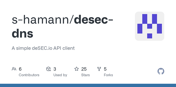

The former is relatively easy if you can get the zonefile (which I suppose Webmin writes for BIND). I do not think the deSEC API can directly import it but there are several third-party API clients. At least this one can import zonefiles to deSEC:
